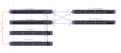

We’re working on the network for a new building that has two routers on the ground floor (floor 0) and a bunch of switches spread across floors 0 to 5, all linked back to those two routers. Each floor has several switches—some general ones and some dedicated to AV (audio/video). If you check out the the topology, you’ll see what I mean. We have 4 normal switches & 4 AV switches that are setup the same way for each floor as this topology. On the right we have our 2Routers on floor 0.

On floor 1, there’s a room with multiple cameras and multiple TVs. The floor has four AV switches. If we connect the cameras to Switch 1 and the TVs to Switch 2, 3, or 4, the TVs flicker. We’re only seeing a few dropped packets, so it’s not obvious what’s causing it. Strangely, if we put everything on the same switch, the flickering stops.
