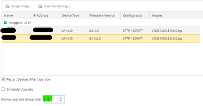

hello,
I want to upgrade some Fabric Engine switches, but I don't want them to restart at the same time. So, when I do upgrade software from XIQ-SE, I put at the device group number as 1, and the download is done one by one, but then the restart is done at the same time for all the devices. Is there a possibility, such that even the resart is done one by one, thus after the first device boots successfully, the second restarts etc.
thanks

Could you try with "Device Upgrade Group Size" equal 1?

It downloads one by one, but the restart then starts at the same time.
