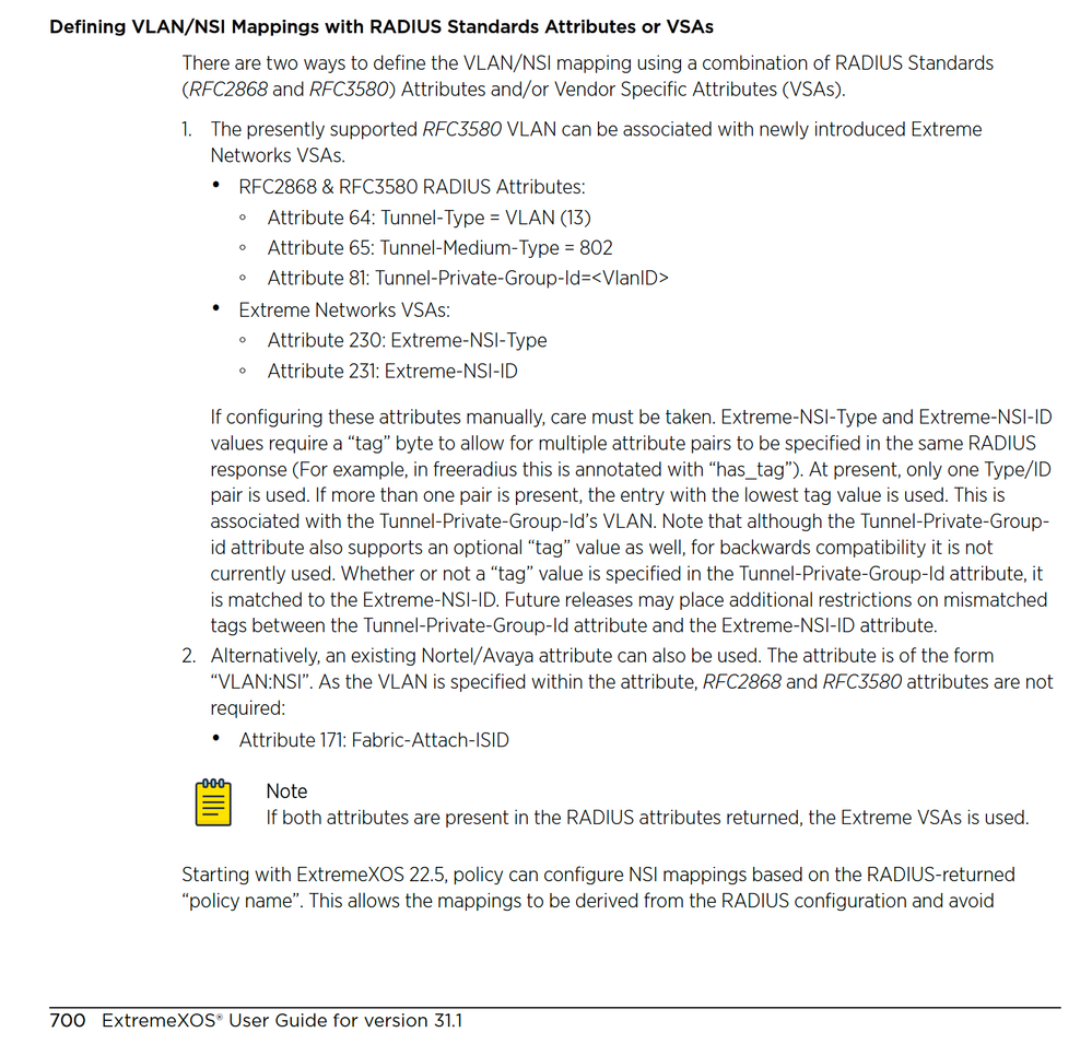

Have a question about the RADIUS attributes. I had not realised you could enable some of those features and wondered how they got configured on the port when the VLAN was dynamically being assigned!
My question is, do you know if those same attributes work with EXOS? or what attributes are available in EXOS I could use. Guess I am most interested in the FA attribute options?

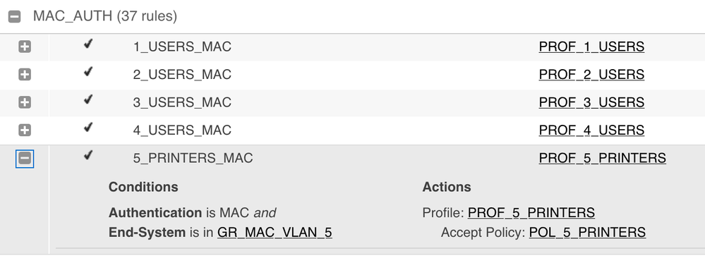

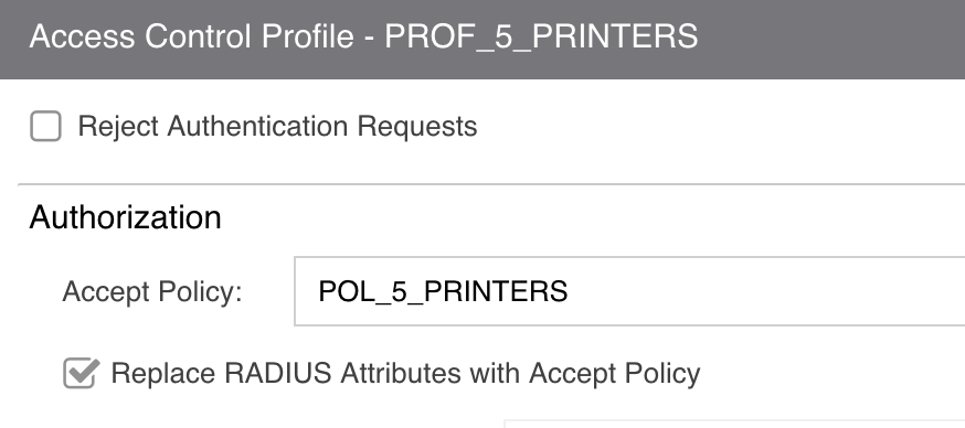

Another use case of same VLAN/multiple i-sid I use is to standardize the vlan config on different remote sites at customer premises.
All the sites are using the same vlan ids while the i-sid are different on all sites. A I use this within different VRFs.
This is keeping the infrastructure understanding quite easy for the customer.
I manage this through aggregated rules in the NAC where the site is the discriminator for the i-sid.
See here some screenshots for the printers with MAC Auth but it applies to all VLANs and with 802.1X Auth:
As you see, one rule fits all the sites (30+).
