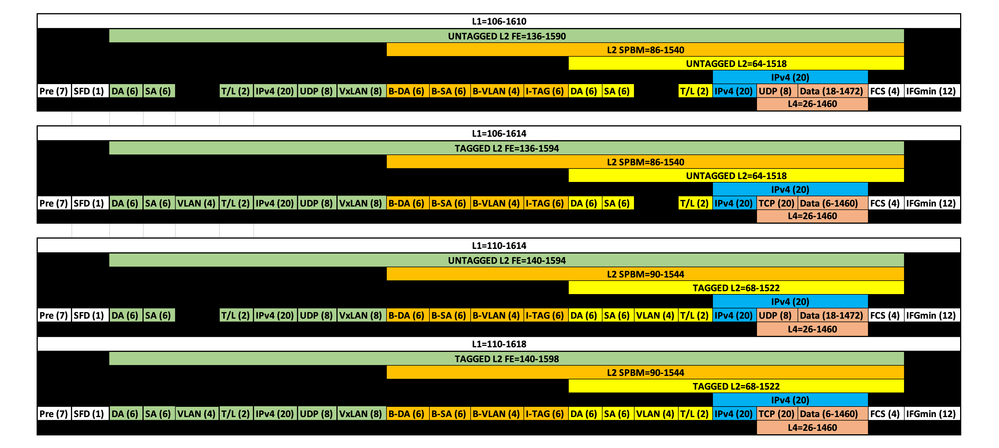

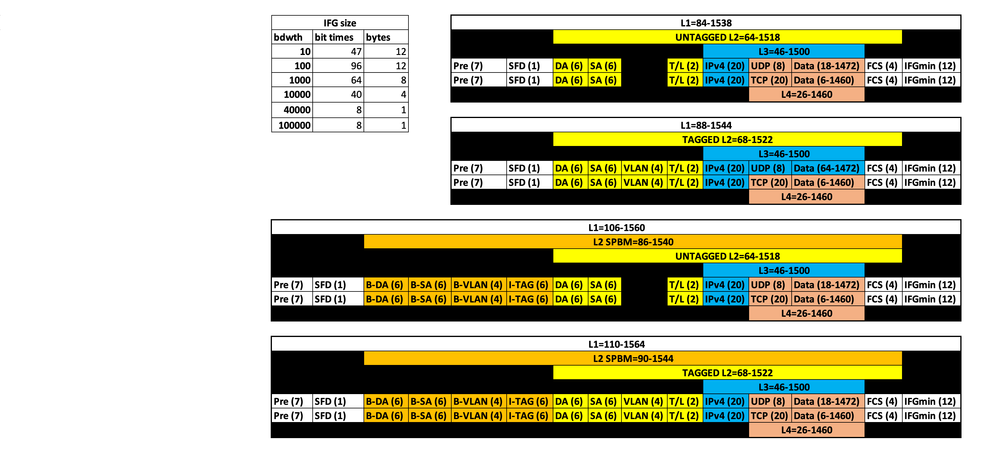

Here the output of an excel when I was on a project to validate the MTU’s and throughput of the Fabric:
Mig

MAC-in-MAC adds 22 bytes to packets; so Ethernet maximum frame size can grow worst case from 1522 (assuming worst case q-tagged packet) to 1544
    64->86    to    1522->1544
Fabric Extend VXLAN encap adds 14 (18 if WAN interface q-tagged) bytes for MAC&etype + 20 bytes (IP header) + 8 bytes (UDP header) + 8 bytes (VXLAN header) = + 50 (54 if WAN interface q-tagged) bytes
    86->136    to    1544->1594    on untagged connection to WAN
    86->140    to    1544->1598    on q-tagged connection to WAN
