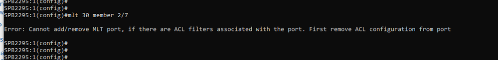

I am trying to add a new Port to the MLT because because we have a problem in th old Port . but i cannot because of fillter acl configration .
i have two Switchs and they are working as a cluster in bckbone . and the there ist one acccess switch connectet withe them with SMLT .
I want to change the MLT port auf one Switche but i cann not and i recieve a Error . that i cannot add port to the MLT because of ACL configration Screenshot 2023-05-23 112703.png
I have tried to remove the Port from Filter ACL and add the port to the MLT but it didnot worked
the BCB-Switch ist VSP-8404 and the access Switch ist ERS 4950GTs
what i have to do i donot know where is the Problem

the information you provided i a bit confusing..
Did you verify the Port ACL table from "show filter acl" command. YOu would see, which filters are assigned to your port 2/7.
Than just remove it using "no filter acl >id> 2/7". hope this helps.
