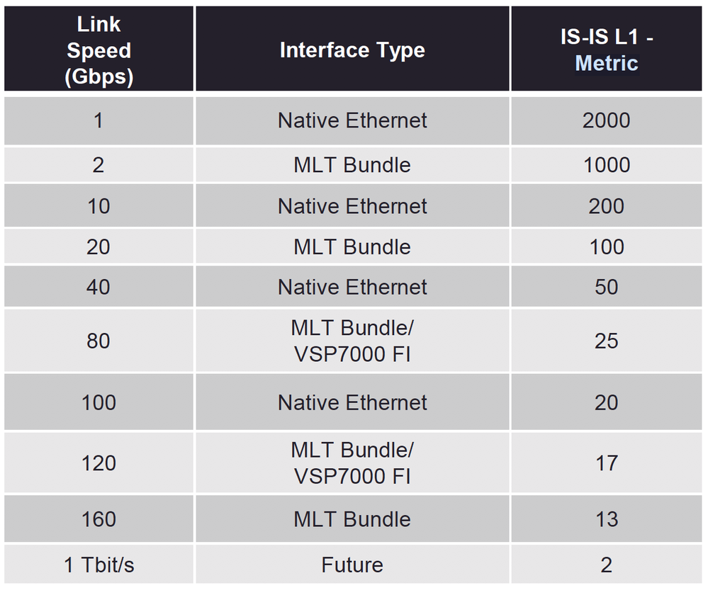

- change the isis metrics of your isis interfaces: the MLT should have the cost of the interfaces 1/1 or 1/5 divided by 2.
- If it is 10G links: MLT=100, interfaces 1/1,1/5 = 200
atm all three are at a metric of 10. i should change the mlt-1 to 5 with the following command, right? can this be done without interrupting anything or do i need to disable isis first?
interface mlt 1
isis spbm 1 l1-metric 5
