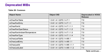

Robert_Haynes
According to these release notes 9035640-01_releasenotevoss_8.0.5_rn.pdf those MIBs you were trying to use were deprecated back in VOSS 7.x+
So yes, there are likely other MIB trees available to poll the similar data.

Robert_Haynes
