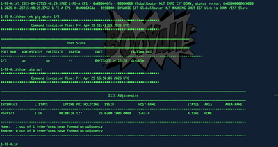

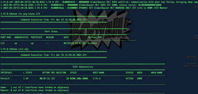

I was able to get the virtual-ist up and running in the GNS3 environment using the new 9.2 image. Oh I was so happy. But, alas it stops working after a couple of minutes.
If we reset the switch it comes up and then a couple of minutes later it goes down again. this is with the new image 9.2 on the github. As much as I appreciate having a gns3 image to work with and believe me I am very grateful. Having something as common as vIST not work is very frustrating to say the least. If there is anyway that I can help get this working please feel free to DM me.
the message that we are getting is.

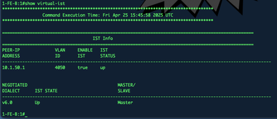

GNS3 VOSS version 7.1 allows for VIST. I created a project with two VOSS 7.1 switches and virtual-IST came up (and stayed up).
VSP-8284XSQ:1#show virtual-ist
IST Info
PEER-IP VLAN ENABLE IST
ADDRESS ID IST STATUS
192.167.0.253 1000 true up
NEGOTIATED MASTER/
DIALECT IST STATE SLAVE
v6.0 Up Master

Thats awesome! However, thats a couple versions short where we are currently.
If it works in 7 why doesn't it work in 9?
06-02-2025 12:05 PM
I've seen the same issue in eve-ng but it's still a good lab environment.
06-03-2025 05:46 AM
Indeed. As I said, I am grateful for it. However, vIST is so widely used, that it not being available, surprises not only me but other customers as well.
