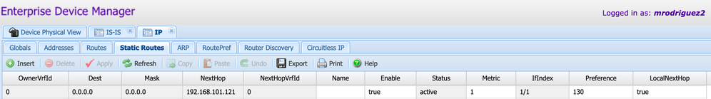

05-07-2021 03:32 PM
Martin,
The last trick (not reccomended but I don’t catch all your setup) would be to declare the next hop as non local changing the last flag in the screenshot here to false:
or via CLI with
no ip route 0.0.0.0 0.0.0.0 192.168.101.121 local-next-hop enable
Mig
