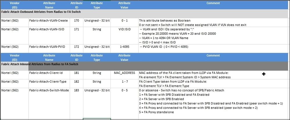

In the documentations for Avaya Fabric Connect Avaya has documented what VSA's to use to configure a I-SID / VLAN mapping for a client authenticated using 802.1x, but they haven't added the VSA information dictionary data. Does anyone have this information?
I'm looking for the dictionary information for the following VSA's:
• Avaya-Fabric-Attach-VLAN-ISID
• Avaya-Auto-VLAN-Create
• Avaya-Fabric-Attach-VLAN-PVID
• Avaya-Fabric-Attach-Mode
• Avaya-Fabric-Attach-Client-Type
• Avaya-Fabric-Attach-Client-Id
Thank you very much.

you mean something like this ?
jprins_at_bette
This indeed the content in the documentation and this is exactly what I was NOT looking for. What I was looking for was the dictionary information. The numerical values that go with the text representation. Without this information the sentences in the documentation have no meaning at all. I have found this information and put it in the dictionary.nortel in the freeradius project.
ATTRIBUTE       Fabric-Attach-VLAN-Create               170     integer
ATTRIBUTE       Fabric-Attach-VLAN-ISID                 171     string
ATTRIBUTE       Fabric-Attach-VLAN-PVID                 172     integer
ATTRIBUTE       Fabric-Attach-Switch-Mode               180     integer
ATTRIBUTE       Fabric-Attach-Client-Id                 181     string
ATTRIBUTE       Fabric-Attach-Client-Type               182     string
ATTRIBUTE       Fabric-Attach-Client-PSK                183     integer
ATTRIBUTE       Fabric-Attach-Client-Trust              184     integer
ATTRIBUTE       Fabric-Attach-Client-Trusted-Binding    185     string
ATTRIBUTE       Fabric-Attach-Service-Request           186     string
VALUE   Fabric-Attach-VLAN-Create       No                      0
VALUE   Fabric-Attach-VLAN-Create       Yes                     1

Hello Jan,
you find this information in the Shortest Path Bridging (802.1aq) Technical Configuration Guide.
Like this:
Outbound Attributes from IDE to FA Switch
Fabric-Attach-VLAN-Create This attribute behaves as Boolean
0 or not send = Switch will NOT create assigned VLAN if VLAN does not exist
1 = Switch will create assigned VLAN if the VLAN does not exit
Fabric-Attach-VLAN-ISID – VLAN and ISID IDs are separated by “:”
– Example: 20:20000 means VLAN=20 and ISID 20000
– VLAN = 1 to 4095 OR VLAN Name
– ISID >0 and < max ISID
Fabric-Attach-VLAN-PVID – PVID VLAN ID
– VLAN = 1 to 4095
Inbound Attributes from FA Switch to IDE
Fabric-Attach-Switch-Mode 0 or not send = Switch is assumed to have not concept of SPB/Fabric Attach (i.e.
switch is in neither mode – not 1, 2, 3, 4, nor 5)
1 = Switch is FA Server with SPB Disabled and FA Enabled (Network Type 2)
2 = Switch is FA Server with SPB Enabled (Network Type 1a & 1b)
3 = Switch is FA Proxy connected to FA Server with SPB Disabled and FA Enabled
(Network Type 2)
4 = Switch is FA Proxy connected to FA Server with SPB Enabled (Network Type 1a)
5 = Switch is FA Proxy Standalone (Network Type 3)
Fabric-Attach-Client-Id MAC address of the FA Client taken from LLDP via FA Module:
FA Element TLV > FA Element ID > System MAC Address
Fabric-Attach-Client-Type FA Client Type taken from LLDP via FA Module:
FA Element TLV > FA Element Type
1 = FA Element Type Other
2 = FA Server
3 = FA Proxy
4 = FA Server No Authentication
5 = FA Proxy No Authentication
6 = FA Client – Wireless AP Type 1 [clients direct network attachment] (e.g. AP 9100)
7 – FA Client – Wireless AP Type 2 [clients tunneled to controller]
