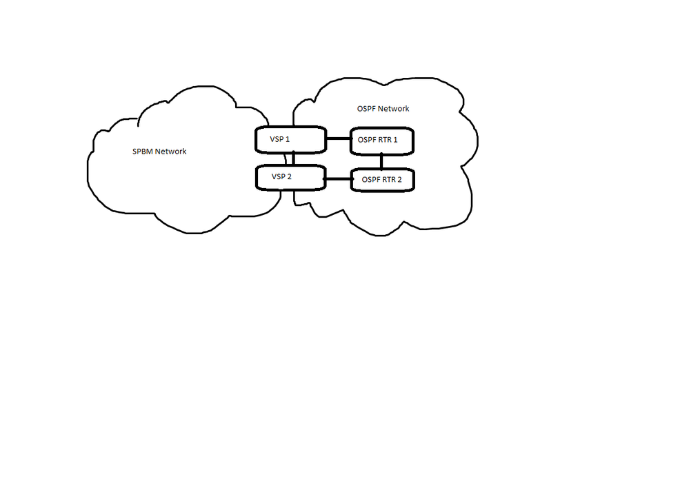

Jay2009
Here is another example.
I do this to stop the routing loops occurring between OSPF and ISIS. Should be able to use this config universally on any pair of switches doing redistribution (diagram attached). You would do this on both peer switches.
(config)#route-map "peer-block-external" 1
(route-map)#no permit
(route-map)#enable
(route-map)#match metric-type-isis external
(route-map)#exit
(config)#route-map "peer-block-external-ospf" 1
(route-map)#enable
(route-map)#match route-type external-2
(route-map)#exit
(config)#router isis
(config-isis)#redistribute ospf
(config-isis)#redistribute ospf metric-type external
(config-isis)#redistribute ospf enable
(config-isis)#redistribute direct
(config-isis)#redistribute direct enable
(config-isis)#accept adv-rtr x.x.x.x (peer spb nickname)
(config-isis)#accept adv-rtr x.x.x.x route-map "peer-block-external"
(config-isis)#accept adv-rtr x.x.x.x enable
(config-isis)#exit
(config)#isis apply redistribute ospf
(config)#isis apply redistribute direct
(config)#isis apply accept
(config)# router ospf
(config-ospf)# router-id x.x.x.x
(config-ospf)# as-boundary-router enable
(config-ospf)# redistribute isis
(config-ospf)# redistribute isis enable
(config-ospf)# redistribute direct
(config-ospf)# redistribute direct enable
(config-ospf)# redistribute static (if static routes exist)
(config-ospf)# redistribute static enable (if static routes exist)
(config-ospf)#accept adv-rtr x.x.x.x (Peer router ID) enable
(config-ospf)#accept adv-rtr x.x.x.x route-map peer-block-external-ospf
(config-ospf)# exit
(config)#router ospf enable
(config)#ip ospf apply redistribute isis
(config)#ip ospf apply redistribute direct
(config)#ip ospf apply redistribute static (if static routes exist)
(config)#ip ospf apply accept
