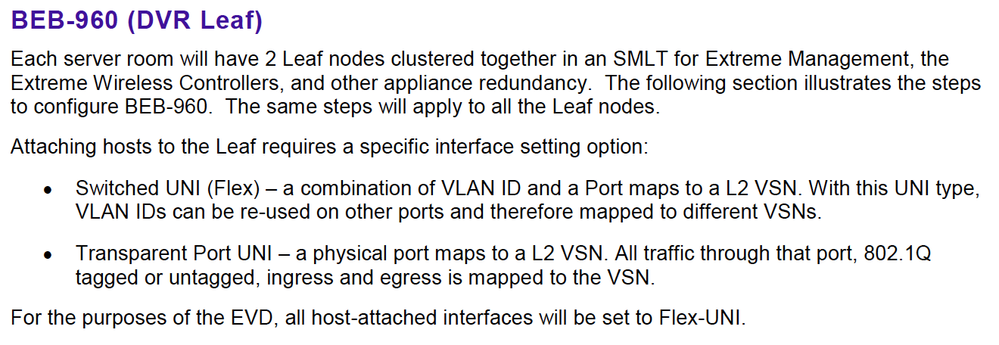

Just looking through the automated campus EVD:
https://kapost-files-prod.s3.amazonaws.com/kapost/55ba7c9e07003d9aab000394/studio/content/5bd9c9a319...3de4d4f7e73/19904-Automated-Campus-EVD_v2.pdf
The query I have is in relation to page 90 where all host attached interfaces will be set to using Flex-UNI, specifically Switched UNI, which I understand is a combination of the VLAN ID and port to a L2VSN, which allows you to re-use the VLAN ID’s to a different VSN.
What I haven’t grasped is the reason to do it in this context, as an example here in the same section lists the I-SID mappings:
I see the reference that the VLAN ID’s configured on the Leaf nodes is only a logical value, but it still only has a VLAN ID associated to I-SID, I don’t see a re-use of a VLAN-ID to a different I-SID and an example of why that would be needed. What I can’t see is where in this case the requirement is dictating the need for it to be a flex port?
Maybe its simply has to be configured that way in the context of using DVR?
The only other time I’ve seen the use of a flex UNI is using fabric attach down to say and EXOS switch, am I right in thinking the port will automatically be configured as a flex UNI, again, I would be interested in reasoning.
Appreciate there maybe a lack of knowledge here, but sure there is a small component I am missing here for the light bulb moment.
Many thanks in advance.
