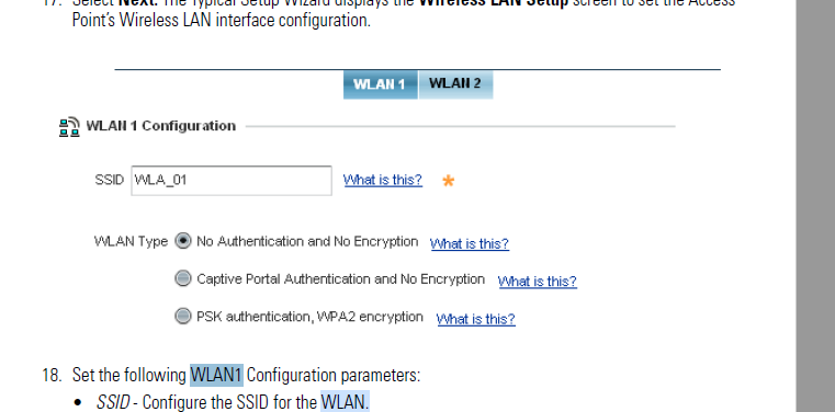

I am reviewing the AP AP6521 user guide as i don’t have access to the kit directly at the moment.  Can someone confirm the maximum WLANs that can be configured is two? Also i would require each WLAN to be on a different vlan.

This AP should support up to 16 WLANs (firmware 5.9.x); however 4 BSSIDs per radio (8 per AP). What firmware version is yours running on?
Even AP6521E (Express) APs should support up to 16 WLANs per device.

Thanks for the info.  It seems to be mixture of v5.6.0.0-056R and 5.5.  Both i expect are very old release.
