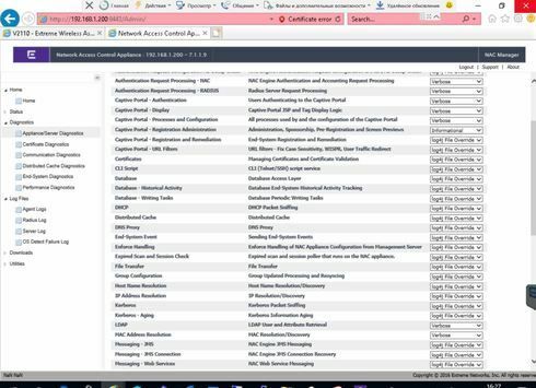

What is .1.111? Which port of EWC? Looks like the Radius request coming not from the port which NAC expecting. Peobably you added EWC with IP address of esa0 but your radius req coming from Admin port? Or something like that.
Yury,
is it enough?
a177f589776340eab91fc8f36135639e_RackMultipart20180523-101653-100tgtp-enough_inline.jpg

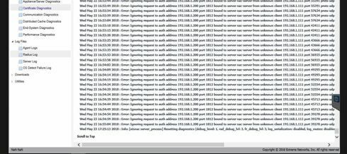

Before turning this on I had such messages in Radius Log:
Does it make something clear?
