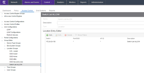

‎12-17-2016 08:36 AM
Hi Ron,
yes I guess it's the only way to add the switch IP static to a location group.
Thank you anyway for your feedback.
Yves
Yves
‎12-16-2016 04:06 PM
You'd also configure/add it via EMC/Control...

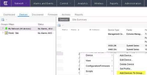

‎12-16-2016 04:00 PM
Hi Ron, thanks for your answer. I know that I could do it this way. But my goal is, that a supporter can add the switch to a device groupt in the oneview.
‎12-16-2016 03:53 PM
Hi Yves, that should work, below a example.
Make sure that the rule is above all other custom rules so it's checked first.
Add the switches to the location group.
-Ron
