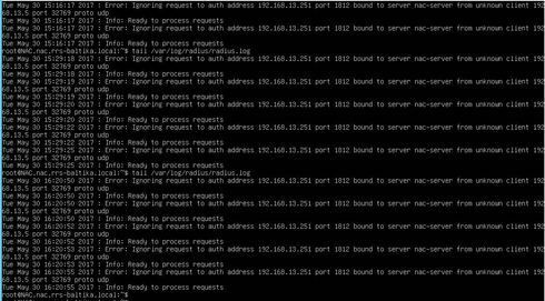

On that time on NAC I have the following:
How can I make NAC to accept these requests?

Hello,
You have to add the switch into the NAC switches tab and enforce in order for NAC to see the switch as an authorized source.
