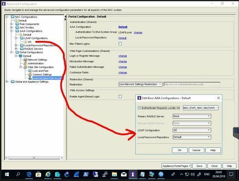

Hello, Yury,
Should NAC be the RADIUS server or who? If NAC, where can I set shared secret on NAC's side? I didn't find such place.
On NAC's side I have only this and AD authorization works fine through portal. Is it OK?
e029ac75bc3b4dfdababaf52c1b4c6a8_RackMultipart20180428-40251-1r7r38n-MegaNAC_inline.jpg
Thank you very much!
If you enable Captive Portal on NAC (and you did) that should be enough. Since you donā€™t see the clients in end-system table check two things : 1. Did you enable MAC-auth on WLAN ? If not please do it. 2. Check the Radius server shared secret is correct For redirect , yes it is global setting and will affect all Captive Portal VNSā€™s configured on controller. There are no side affects, only pop-up on client ļ™‚ Btw, your non-auth and auth does not matter, in your case NAC is the master abd controling what roles are assigned (via sending Filter-ID back to controler)
