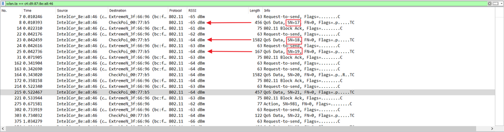

It took me some time to check the packet capture, only one capture file had some meaningful data. The good thing is at least in the captured data the RF looks ok. I don’t see any retransmission of the frames and if you see the packet sequence, there is not much of a difference RSSI. it looks consistent.
One other thing that I have noticed is the channel utilization caused by the SSID “Stapler”, this SSID is comsuming most of the airtime on channel 11. I could only see channel 11 in the capture because the AP you might have used to capture the data was on channel 11 as well.
The Block Ack that you mentioned in your previous response is not a concern, its just a mechanism for the AP to send acknowldements in blocks instead of individual acknowledgments which consumes more airtime.

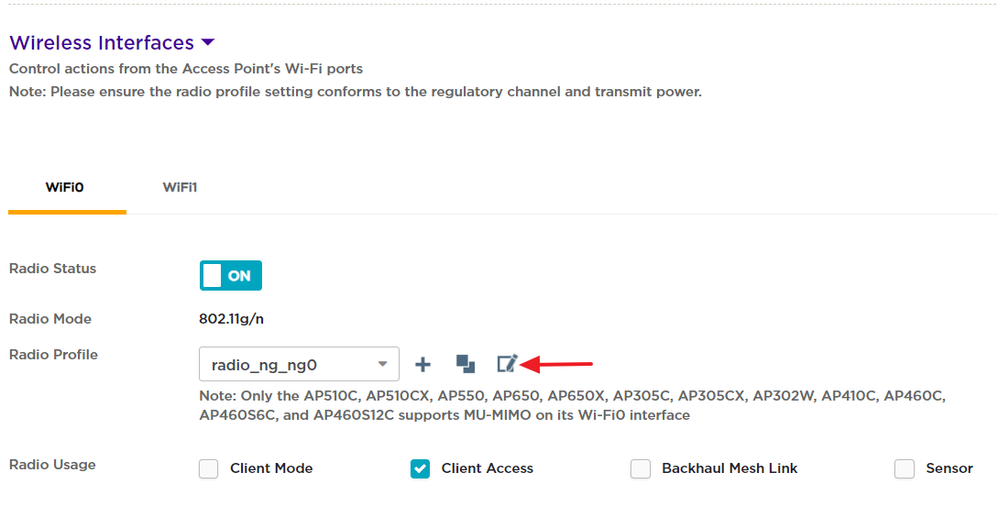

I say you try following settings in the AP device template under radio interface settings:
Deny connection requests from legacy clients using - 11b (Enable to get rid of 11b legacy clients)
Background Scan - OFF
High Density Configuration - OFF
Band Steering - OFF
Client Load Balancing - OFF
Tx Beamforming - OFF
MU MIMO - OFF
Dynamic Channel Switching - OFF (keep it OFF for a while)
Weak Signal Probe Request Suppression - ON (set value to 15dbm first and then wait to see the diff., it should help free up the channels)
If all of this does not improve the situation then I would recommend to create a test WPA2 SSID and connect a test client with it to test the connectivity and see if faces the same problem.
Send me output of #show int wifi0 counter from few APs where you see issues the most.

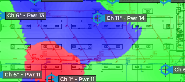

Most of the things i posted in here were from the “main” ap in the middle of the loading hall. It’s this area on the screenshot i posted, with three APs (channel 1,6 and 11). The ones you can see at the top or in the corners are either outdoor aps or in different halls.
I have checked the three aps in the hall right now and their summary state is on all three “good”. The CRC rate right now is between 8% and 17%. I will check these three aps again as soon as the number of forklifts in the loading hall rises up due to more trucks being loaded.
