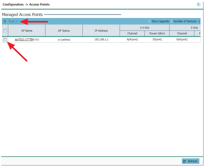

6- Its an Enterprise WiNG AP running WiNG Swift UI. Please get us Techsupport file by navigating to AP > Tools > Techsupport. First, reproduce the issue and then take the techsupport file.
-> I Attach the Techsupport file.
Lets take a look at the config first, and see if we find anything unusal in the techsupport dump. If not, then we will need some packet captures to investigate this further.
