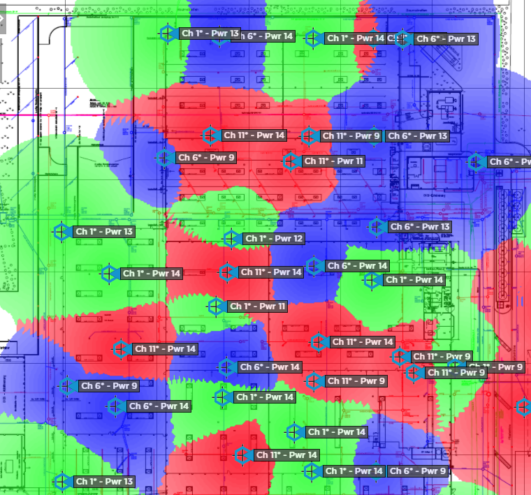

- we replaced around 67 Motorlas with 50 Extreme APs. I should note that we got a few outdoor APs (460c) and you wont see all APs on the screenshot down below, because the plant split into one Big and one small hall which i did not screenshot.
- On the whole plant? Around 20-30 (10 forklifts, most of the rest are iphones using 5 Ghz in a sepperate SSID)
- This is a screenshot of our plan. Sadly we dont have a good layout of the plant, i also haven’t done walls yet, since i dont exactly know where which kind of wall is. In the areas where you can see more APs we have full water / softdrink bottles (we are a Beverage manufacturer) and this results in the water absorbing the wlan signal and creating signal holes. So we needed to place more APs to cover up the holes.
I have created a schedule for the aps to check their neighbor channels every evening and switch channels, if needed. -

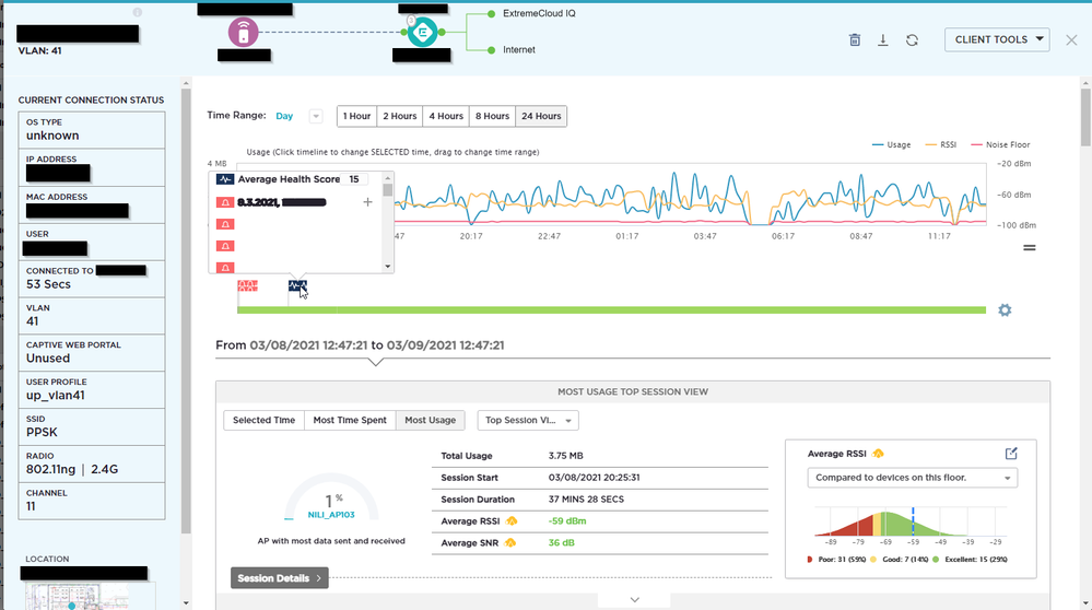

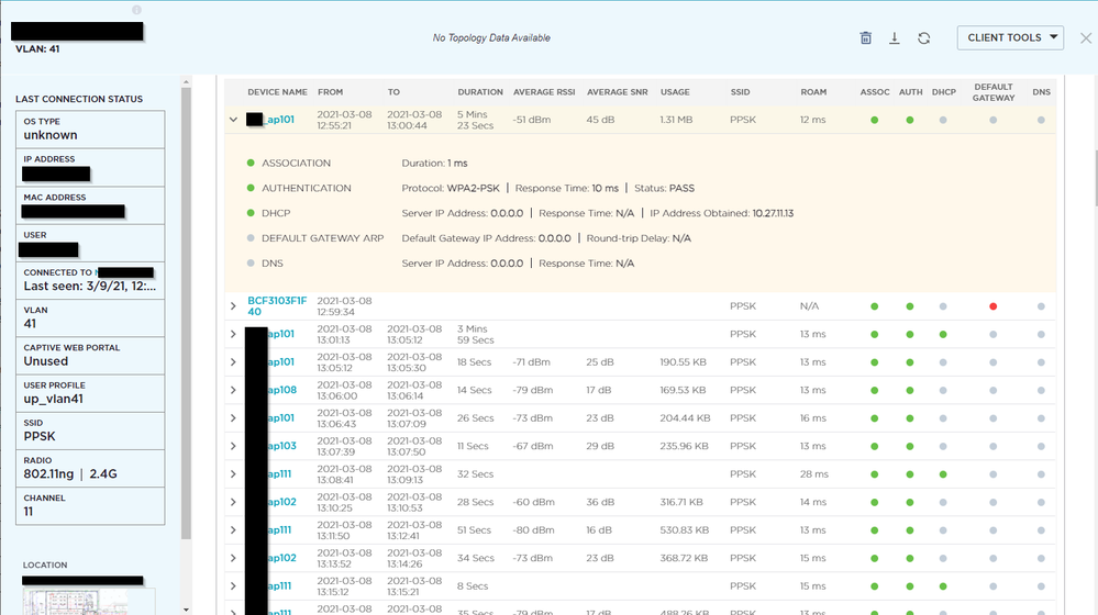

Here a Screenshot like you requested it. I hope you can see everything you need.
I noticed that i dont see any “roaming time” like in your screenshot. So when i click on the “green bar” i only see the Health Score and errors.

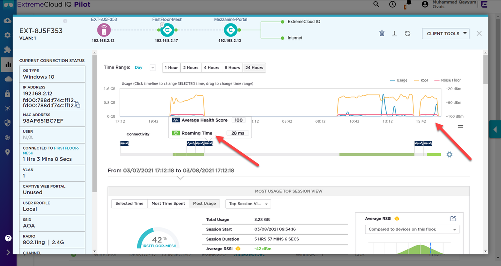

- Pick a client that has shown issues while roaming. Check the following client stats in Client 360. Look for roaming time value and check RSSI, SNR, Floor Noise and Usage. You can probably send a screenshot of this screen from your setup.
- Scroll down on the same screen and check following:
