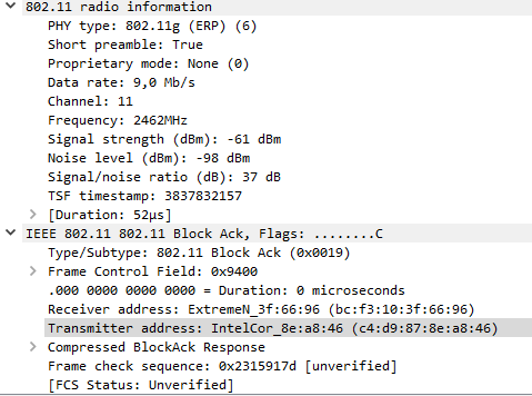

I just checked the CRC Rates on two of the Aps which had a high rate on Friday again and know it’s pretty low. One ist at 9%, the other at 13%. The rretry rate is at 4% and 5%.
I’ve got two packet captures (one from friday and one from today). How i should i post them here? Guess with the character limit of 3000 i cant post really much.
What I’ve noticed so far is a decent amount of blocked requests by the ap because of too low bitrates (basic is 11mbit most of them are either 1mbit or 9).
But shouldn’t the newer and more “intelligent” aps able to cover the area as good as the old ones or atleast more optimized? We did place them like the wlan coverage by our partner reccomended them. I would guess that the motorola aps had way more overlapping cells than the current one causing more interferences. But that is only guess. I never heard of any intense problems with the old wlan for as long as i am working in the company.

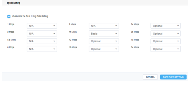

13-15 is what extreme says in their workshops.
Did you check your Rate Settings?:
