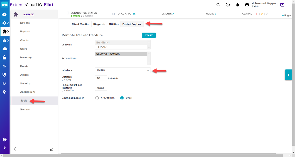

Why did he chose channel 11 even though the other two aps who are nearby are on the same. Is it because they have a too low signal strength for him to change it and he doesn’t see a problem in it?
I will try to get a packet capture and will visit the plant in two weeks to get some more information from the client side.
03-09-2021 06:29 PM
Were you using external antennas on AP5131? How high are the APs mounted?
How many SSIDs do you have in total?
From the RF plan perspective, it does not look that bad apart from the upper right corner of the screenshot where most of the APs are using channel 6 (purple area). But again, this is not 100% realistic and we need to have some RF packet capture taken from a client to figure out if there are excessive retransmissions of the frames probably due to the height of the APs, integrated antenna, and metallic objects in the warehouse.
Some helpful commands to verify channel/power issues:
#sho int // to see BSSID
#sho hive // to see hive name which can be used to identify Cloud APs on the same channel
#sho acsp neigh // to see background scan list and then look for VHM hive name to easily identify BSSID of Cloud AP on the same channel
This should give you an output similar to the following, that will allow you to see how many of your APs are on the same channel and how well can they see each other, if its too strong of a signal you have too many APs (or high Tx power) and you should either reduce the Tx power or turn off some of the APs (but I doubt this would be the case), if the signal is too low you have less APs.
wifi1(6) ACSP neighbor list (17/384): Bssid Mode Ssid/Hive Chan Rssi(dBm) Aerohive AP CU CRC STA Channel-width VID NVID be4d:fbbf:9860 Access 3sCompany-5G 36 -87 no -- -- -- 40+ - - 206c:8a05:1924 Access AOA 36 -58 yes 7 17 2 20 1 1 206c:8a05:1920 Backhaul VHM-CYRUJRGN 36 -57 yes 7 17 1 20 1 1 989d:5de9:77aa Access kikobull-5G 40 -77 no -- -- -- 80 - - 2405:8823:8f8b Access google 149 -85 no -- -- -- 80 - - 2405:8823:8546 Access google 149 -62 no -- -- -- 80 - - 2405:8823:9b67 Access google 149 -75 no -- -- -- 80 - - 3894:edf2:c882 Access NETGEAR77-5G 149 -77 no -- -- -- 80 - - 4065:a3ab:1097 Access BELL918 157 -89 no -- -- -- 80 - - 989d:5de9:77ab Access 40 -76 no -- -- -- 80 - - 989d:5de9:77af Access 40 -76 no -- -- -- 80 - - 989d:5de9:77ad Access 40 -76 no -- -- -- 80 - - 989d:5de9:77b0 Access 40 -76 no -- -- -- 80 - - 2605:8823:8f89 Access 149 -86 no -- -- -- 80 - - 2605:8823:8545 Access 149 -61 no -- -- -- 80 - - bcf3:102b:80b0 Backhaul hive0 36 -48 yes 0 0 0 20 1 1 36f1:50c4:47c0 Access DIRECT-roku-L0J-417A8... 36 -54 no -- -- -- 20 - -
To solve this issue, you need to first determine if it the application disconnect or client disassociation/disconnect. if its client disassociation/disconnect, the cause could be roaming, bad coverage etc. If its only application disconnect, it could be due to bad RF, retransmission to being with, and the best way to check it would be to connect a client to an AP, don't move the client and check if the application still disconnects.
While doing it take packet capture, without it we can’t determine the issues in an effective way.
Regards,
Ovais
