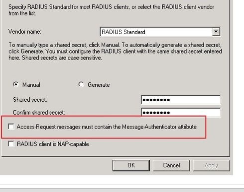

I would also double check that this Access-Request message box is not checked:
3659d7a0ef1844c8b5cad6ed7fe5fd6f_RackMultipart20160621-121919-1v0nti9-radius_access-request_message_inline.jpg
If nothing above helps and it's still not working, I would suggest opening a case with GTAC and we can investigate further.
