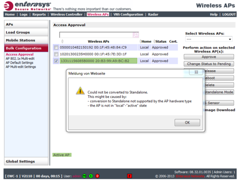

Error message appearing if you try to convert a 3700 series AP:

Are there any plans bring back an autonomous AP firmware for the 3700 series? Only practical solution i know is to use the "restart service in absence of controller" feature as workaround.
Doug
You cannot convert an ap to standalone mode unless the model number was standalone to start with (example 3630/40). Doug Hyde Sr Support Engineer
