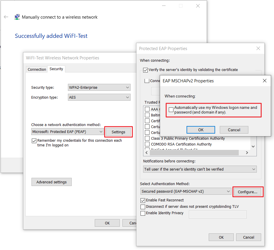

First to test it, you probably need to check in the wireless network settings if your client machine is configured to automatically use Windows Logon name and password for this network, if it is, then try un-checking the option as following and test, it will prompt you for password everytime you connect to the WiFi. Doing this should not require you to re-create the wireless network profile everytime you change the password.
