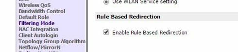

I have enabled HTTP Redirection globally:

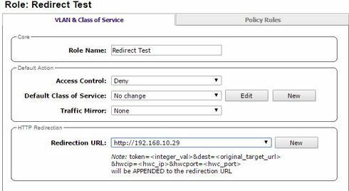

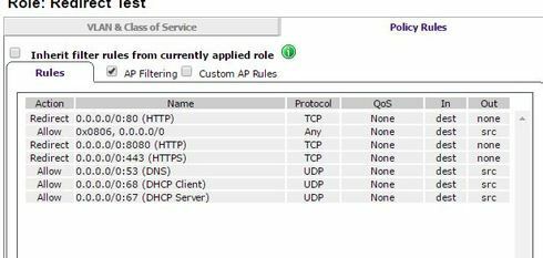

I have created a redirection role with the following rules:
The user connect and receives an IP, but is never redirected.

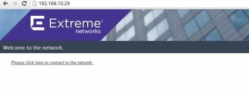

If I browse to the "Redirection URL" I do get the NAC Portal Page:
Looking at the note at the bottom of the "Redirection URL"
Note: token=&dest=
&hwcip=&hwcport=
will be APPENDED to the redirection URL
This might be the problem....
