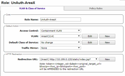

I have enabled HTTP Redirection globally:
I have created a redirection role with the following rules:
The user connect and receives an IP, but is never redirected.
If I browse to the "Redirection URL" I do get the NAC Portal Page:
Looking at the note at the bottom of the "Redirection URL"
Note: token=&dest=
&hwcip=&hwcport=
will be APPENDED to the redirection URL
This might be the problem....

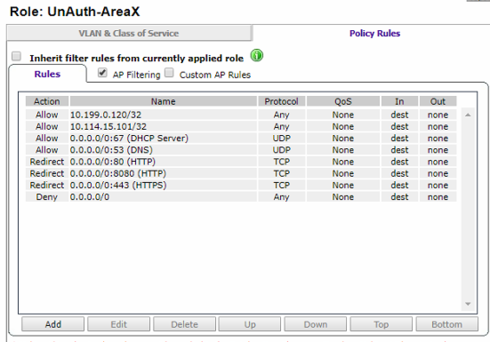

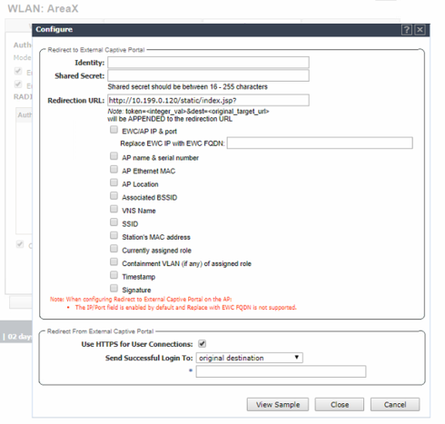

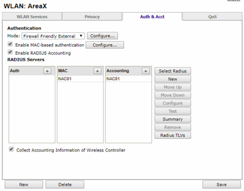

Have it working, screenshots of the configuration below. I did end up using FFECP but I didn't need to fill in feilds except the URL.
68f44acc7b294b1dbb3ffdcda3fc9e7d_RackMultipart20170922-101466-1s2xkw8-Rule_inline.png
68f44acc7b294b1dbb3ffdcda3fc9e7d_RackMultipart20170922-120594-zc4rtt-RuleRedirect_inline.png
Mistakes I made to avoid:
  • Make sure redirect rule is set to 0.0.0.0/0 for HTTP and HTTPS, and not NAC IP (As Above)
  • Make sure you enter NAC IP address in, otherwise you get an 'Internal Error' when redirected (As Above)
  • You don't need to fill out any fields in FFECP config other than URL (As Above)
  • IP 10.199.0.120 is NAC
  • IP 10.114.15.101/32 can be removed, this is a mistake. This was a hangup when originally configured for Bridge@EWC

Hi, Been in the process of setting this up myself but been struggling also to get the redirect working. (Think it might be having the redirect firewall rule set to the NAC address instead of 0.0.0.0 as above, as you would traditionally do - will test and post back) Would it be possible to provide the detail of an exact working configuration that redirects to NAC Captive Portal - the above details 90% of it but not sure how accurate it is and some bits are missing like if FFECP was required, and its elements. Are the settings above, all the firewall entries exactly how they should be? Did this require FFECP in the end to work? What was entered for the mandatory fields, like 'identity' for example (perhaps wireless controller hostname?) I'm running on code 10.34.x Many thanks.

Hi Gareth The FFECP only applies to routed or b@ewc topologies. With new redirect options should allow you to redirect traffic with a Bridge at AP topology. I have tried to set this and the controller then warns you that it only applies to routed and B@EWC topologies. Enhanced Access Points (AP38XX/39XX) to directly support redirection and Firewall Friendly External Captive Portal (FFECP) for distributed topologies. Thx
Andre
My understanding is that the wlan service must be of type FFECP (see the manual pages in my first post.)
If it is not, and the identity/shared secret fields are not complete, the AP will not redirect.
I would recommend attaching your configs to a case and we will take a look at it, I have it working in the lab on this code, in a wireless trace I see the AP sending http redirect.
