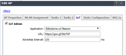

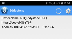

Hey Andre,
I run the same version, I configured the url from the example on Github and it works fine as far as I'd see.....
https://github.com/google/eddystone/blob/master/eddystone-url/README.md#eddystone-url-http-url-encod...
What url do you use - I'd try the same on my AP.
