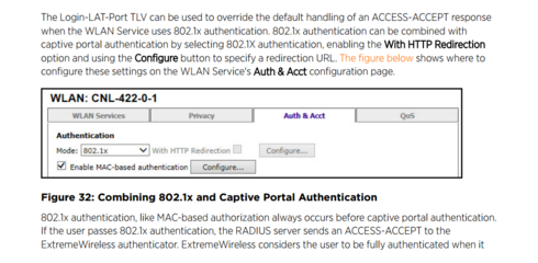

Hi AG,
thanks for that advice - in the past i only have V9.15 Wireless Integration Guide!
The link above is V10.01!

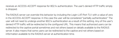

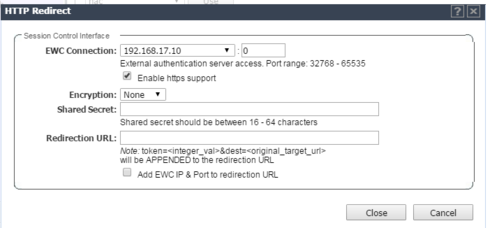

Here you can see - how it works:
It seems that you can even enable HTTPS Support (which is very desireable!)
Sounds good!
