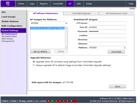

‎09-22-2016 05:24 PM
Always upgrade = as the AP connects to the controller the software is upgraded/downgraded to the default AP image which is generally/default the same software version that is running on the contoller
Upgrade when = you as a admin of the system could perform the upgrade/downgrade manually
It comes handy if you upgrade a controller pair and don't want to upgrade all APs at once (always upgrade) instead you could upgrade some APs at a time, wait till they are up and then upgrade some more (=upgrade when).
If the AP is not connected to the controller it's normal that you don't have the same software as the controller.
So fix the connection issue and the AP will connect and upgrade (if always is selected which you should set),

‎09-20-2016 12:55 PM
What is the difference between these 2 "Upgrade Behavior" settings? What should it be on? It was on "Always upgrade", but I just changed it to "Upgrade when", because the APs that I have installed are not coming up, they are still saying Inactive in the Topology.
