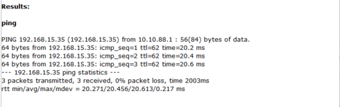

When trying to register my AP3805i Accesspoint on my remote site that is connected via PPTP Tunnel at my V2110 Controller, I don't succeed. Accesspoints are shown in the AP List, are approved, set the right MTU size (checked with ping), are pingable (both ways), but when i check the TCP Dump of the Controller i see the AP sending ?Discover? and then try to Register 5 times (both WASP Protocol) but there is no answer but another ?Discover? from the Admin interface of the controller.
My Topology is as follows: admin interface 10.10.89.1 Gateway 10.10.89.2, PPTP Tunnel 10.10.89.2-10.10.89.200, physical 10.10.88.1, 10.10.88.x routed, IPs at the remote site 192,168.15.xxx routed, no masquerading (NAT), B@AP untagged for the wireless setting

thats the ping statitics i got
afc3a7c8be7b435baaeb1aa0e821164d_RackMultipart20160517-15051-7vtqmt-Ping_localAP_fromWC_inline.png
