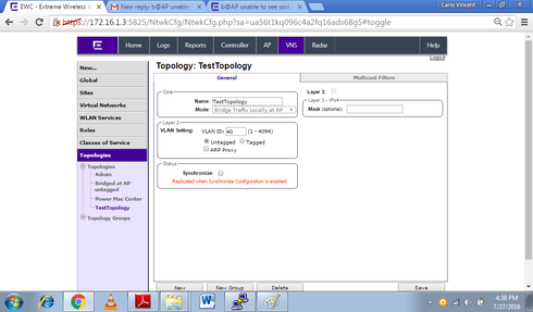

Hi i configured a WS3825i AP with a use of a C35 controller. I created a topology b@AP. i followede every steps in the gtac guide and also used VNS wizard more than once to do this policy in the AP. But everytime the AP is restarting to collect the policy created it didnt broadcast any SSID I created. I was planning to deploy this AP in a remote site where there is no wireless controller available. Could anyone of my seniors here help me with my concern? Thank you in advance.

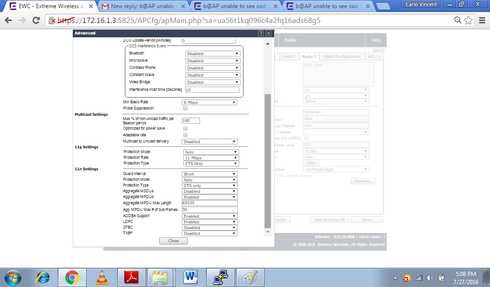

Could you also please post the AP2 radio2 window.

The ap is connected to the controller via a switch. Eventhough its connected to the controller its still not broadcasting any ssid. I havent placed any IP on the ap yet. Please see attached images, i hope this would help. Thank you.
