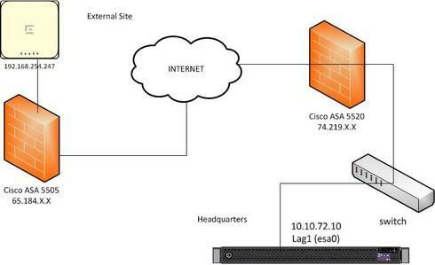

Here is a poor man's network drawing of the setup, which confirms how you believe that it's set up.

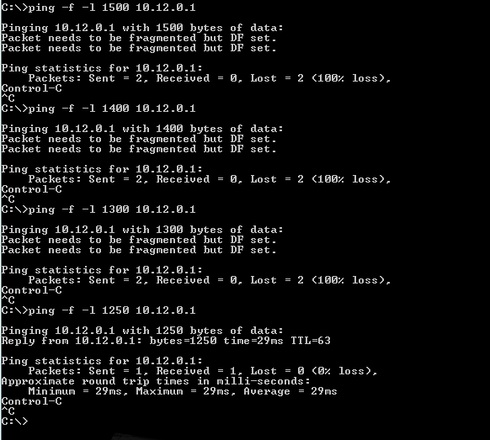

You'd also try with your PC@home to ping the internal controller IP and set the "don't fragment bit" to check the max. MTU on the link.
Here mine.. as you'd see I doesn't work with 1500, 1400, 1300 but is OK with 1250.
Even the ping show that 1300 isn't working I use that value on my AP because as as far as I'd remeber the windows ping takes the buffer size (1300) and adds the header = a larger frame is send.

So to the IPs - is that correct...
controller internal = 10.10.72.10
controller ext = 74.219.x.x
AP external = 65.186.x.x
What's your MTU ? Set it to 1300 on the controller and reboot the AP please.

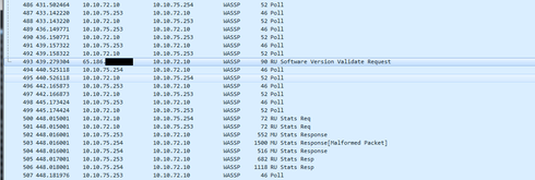

And then here is what the controller is showing when I run a capture against this interface ...
44894bafd50c4cc08dc3f22a6873a655_RackMultipart20160222-97346-79aaa2-externalthing_inline.png
If I perform a ping to the external IP of 65.186.X.X from the controller interface (10.10.72.10) I get replies. But it sure seems like it either a) doesn't know how to get the traffic there or b) it just doesn't *want to*.
