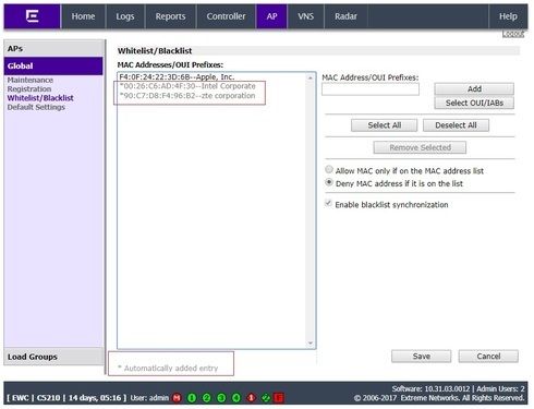

I have a client that cannot join my wireless network and they appear to be on the Blacklist. I didn't put them there, and I cannot seem to remove them because they were "automatically added"? What would have automatically added them?
I am assuming that this was a false detection by RADAR? But how can I get them off this list if it's grayed out on me?

It appears that disabling the settings in your In-Service Scan Profile do *not* remove hosts that have been automatically added.

Hello Gareth, in this case it was for "surveillance" or "excessive null probes from client". I have seen false detections with this attack on other systems as well (Cisco wireless). My only guess is that it's a client that is misbehaving. Possibly trying to join an AP that is too far away, or maybe it roamed and is failing to reconnect at the new AP?
In no cases has it ever been an attack of any sort (at least in my experience). Just a domain joined laptop running Windows 7 which recently 'stopped working' without warning.
I found what you are referring to. Just to clarify, that is under Reports > Radar > Blacklisted Clients. I didn't think to look there. But now I can see that it does show when a client will leave this blacklist on its own. And that is good to know!

The report Radar>Blacklisted clients gives some info of start and end time of the blacklisting along with a reason, as far as I know there is know way to decrease or force the de-listing of a blacklisted client, that could be done as a feature request via your local SE.
What was the reason for the blacklisting, do you have that info as it probably should be investigated?
