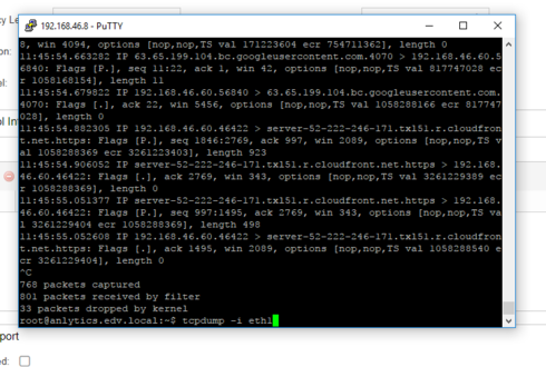

I have configured on my EWC the Netflow / Mirror N, with the eth0 Target IP from Purview and
the esa 1 from EWC as Mirror Port.
On the Purview Side i have configured the EWC as source of Flow with his MGMT IP.
With a tcdump -i eth1 on the Purview, i can see that all traffic from EWC is mirrored to the analytics appliance.
But this traffic will not processed, under the tab "Appliaction Flows" there is noting to see into the analytics section of netsight.

9c230999beac4f99a28dbab881ba6e87_RackMultipart20171203-28097-wltc10-Anaytics_4_inline.png

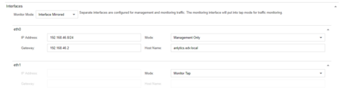

With a :
9c230999beac4f99a28dbab881ba6e87_RackMultipart20171203-10218-o4gqwi-Anaytics_1_inline.png
