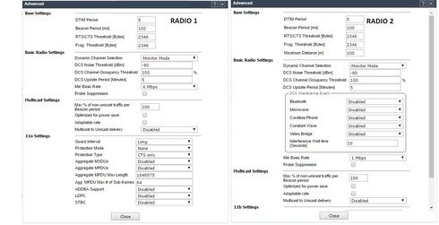

Check ATPC and DCS settings. Disable ATPC and change DCS to monitor mode to test.
Post screenshot of radio settings and advanced radio settings.

Hello Evan, thanks for the help. It appears that my ATPC is already disabled, and DCS is already set to Monitor.
Here are screenshots of my radio settings, and advanced radio settings.
