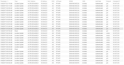

I had a user who got dropped this morning at approximately 9:15AM EST. I think she may have been disconnected several minutes earlier, and didn't realize there was an issue until 9:15AM EST when the device was rejoining.
Here is a snapshot of the client events ....
388daee4b0f24b3bb778a023a246d8db_RackMultipart20170130-16515-3540nq-ClientEvents_inline.jpg

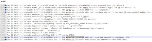

And here are some log snippets.
388daee4b0f24b3bb778a023a246d8db_RackMultipart20170130-79578-5hprrf-PT-AP2_inline.jpg
388daee4b0f24b3bb778a023a246d8db_RackMultipart20170130-55925-1ts3w3l-PT-AP4_inline.jpg
388daee4b0f24b3bb778a023a246d8db_RackMultipart20170130-48808-1umegdt-PT-AP1_inline.jpg
