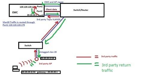

‎03-15-2016 07:53 AM
Hello Jason,
Thanks for the sample. And the router will route back the return traffic as I show with green arrows, right (via static route to port 1 ip)? IIRC the first setup was like this. But I will reimplement it and return back to you.
Thanks,
Rahman
