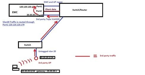

I apologize for not getting back to you on this question. I re-read what I wrote and it is confusing! I don't think I was explaining my thoughts clearly. I wanted to make sure there was no other duplicate interface for your VLAN 60 on the network.
I have attached the topology that I am using in our lab.
139c994988b647a5abaaf20555a31068_RackMultipart20160314-68789-uub4ay-3rd_Party_Network_Topology_inline.jpg

Here is the last tip I got from GTAC;
Hello Rahman,
Is it possible for you to route the 3rd party VNS outside of the controller? This VNS should be kept separate from the rest of the controller, so that there is a route BACK to this VNS on the network, but not "through" the controller. Is it possible for you to configure it this way and re-test?
Regards,
Jason
So anyone uses 3rd Party VNS can explain me how should be the physical topology? The 3rd party vns clients uses controller ip as their gateway so how is it possible to "not route through controller"?
