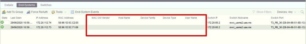

I already made a configuration enabling mac auth in the test WLAN Services, and the users I can already see in the NAC endsystems, the problem is that I cannot get the devices to show me device type information, hostname, etc, etc.
Does anyone know if I need to do something?
I will greatly appreciate your help.

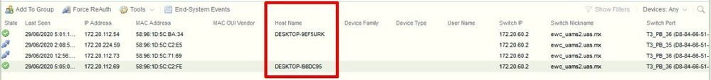

Thank you very much Christian, I already applied it but it only showed me the hostname, the rest of the information is still blank.
Regards.

I have a C4110 controller and a NAC Appliance, I want to display the end systems and also the type of device, device family, hostname, without the need for user interaction.
Already set up a WLAN, enable MAC-based authentication by setting the NAC as Radius server.
In the NAC I already see the end systems but the device type, device family, hostname is still not shown.
Does anyone have any idea how to do it?
