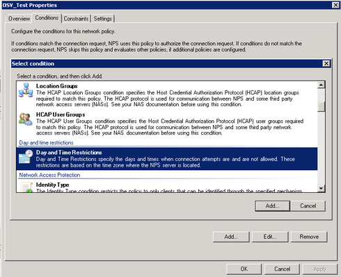

If you use RADIUS authentication you'd also add a restriction so access during the night is not allowed.
i.e. for Windows NPS add a date/time restriction in the network policy....
acb1d2c37d2349d488eef44fb345c428_RackMultipart20150819-23398-1h2tgn4-AD_restirct_datetime_inline.png
-Ron
