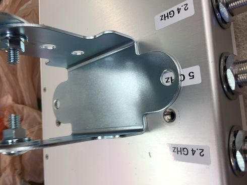

I was working with a customer on a major wireless deployment when we discovered that there are no bolts included for attaching the articulating mounting bracket to the WS-AO-DE07100N, Outdoor, 2.4-2.5/5.15-5.875GHz, 8-feed, 7dBi, 100 degree panel antenna. I ended up ordering the required bolts from boltdepot.com, 1-866-337-9888. The Bolt Depot part number for the bolt is 16062 with a description of “Hex bolts, Stainless steel 316, ¼’’-20 x 1/2’’
Hope this helps,
George
