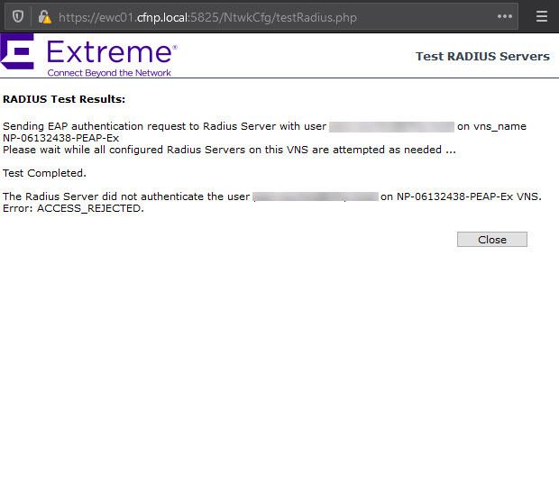

I have Extreme Management Center (XMC), Extreme NAC and Extreme Wireless (V2110) configured in my environment. XMC is acting as a Radius and it is successfully authenticating users. My issue is with configuring 802.1x (PEAP) authentication on an SSID. I configure 802.1x and set the Radius server options. When I test the Authentication server within the wireless controller I get the following error:
Not sure where to go from here. Thanks. - Paul

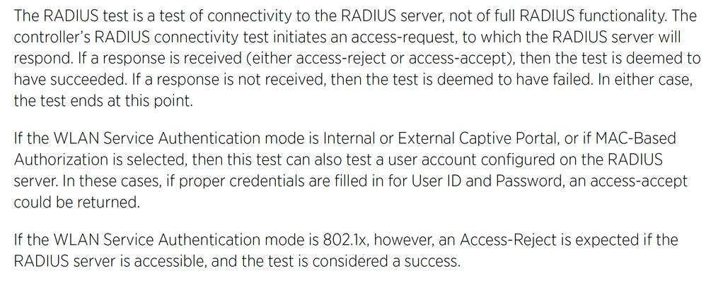

And as mentioned by
Here from the doc:
