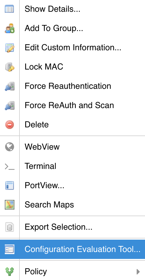

Miguel-Angel_RO
Valued Contributor II
Hi PG,
Go to the NAC/Access Control/Engine Groups/[Group Name]/End-Systems.
Locate the failing authentication and right click on it to execute the Configuration evaluation tool.
If it is not clear, please share the result for comments.
Mig
