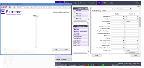

If i try to set the my 2,4 GHz channels to custom 1,6,11 (which is common here in Austria and not the suggested 1,7,13 plan) i don't have the ability to select a channel because the list in the popup that appears is empty.
Does anyone have a similar issue?
Controller is a V2110 on 10.01.01.0129, Access Points are 3805i
Settings are Radio2, b/g/n, 20MHz, Country selected - Austria, Channel selection Auto, AutoTX
any ideas?

‎06-29-2016 03:00 PM
That is a bug - I've reported 2 tickets back in March regarding issues with the channel-plan pop-up.
One was fixed in 10.01.04.0011 and the second one in 10.01.05.0008.
So you'd need to upgrade to the latest release.
From the release notes....
wns0014416 & wns0014415, Fixed channel plan pop-up when adjusting large number of APs in multi-edit
Here a screenshot of the issue...
Upgrade done -everything working now - Thanks for your answer!
