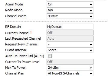

How come when I restart the wireless controller C5210, all of the radio channels show "off", even though none of the APs are down? I want to be able to see what channels the APs are using, so I can change them in case interference.
048882d2eb024a9ab63ce7e3039ee16c_RackMultipart20150423-16913-10j2o0j-radio_channel_off_inline.png

On the active controller please open GUI > Reports > APs > active APs.
Is the AP listed that you are talking about ... if not try the same on the foreign controller and let us know the result.

I think this is the local controller. We have 2 controllers, the other one is the foreign controller; which we have not used yet.

If the access point is on the backup controller, you will not get stats from the access point until it's released back to the local controller.
Take a look at the following knowledge document....
http://gtacknowledge.extremenetworks.com/articles/Solution/Access-Point-radio-is-not-showing-a-chann...
