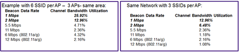

Here some data from a presentation...
aa0c6602520a492abaa54e7f3104f343_RackMultipart20160819-43703-1dgad9f-util_ssid_inline.png
With 6 SSIDs on this 3APs in one area and a min basic rate of 1Mb (2.4GHz band) you get a channel util of ~26%.
That would mean that 1/4 of the bandwidth is uses for managment frames (beacon frames).
Less SSIDs and a higher min. basic rate could reduce that a lot so you've more airtime/bandwidth for real user data.
You'd have up to 8 SSIDs per radio = 16 SSIDs per AP which isn't a problem for the AP but result in more managment frames = less airtime/bandwidth for user data.

3 SSIDs is a common recommandation. The management frame/airtime overhead also depends on the wireless basic rates. You could really speed up your wifi by disabling lower data rates, but you should be carefully testing your clients and you wifi design must support the lowest data rate for example 12 Mbps at the edge of the wireless cell.
A more detailed article about SSID overhead can be found here:
http://www.revolutionwifi.net/revolutionwifi/p/ssid-overhead-calculator.html
