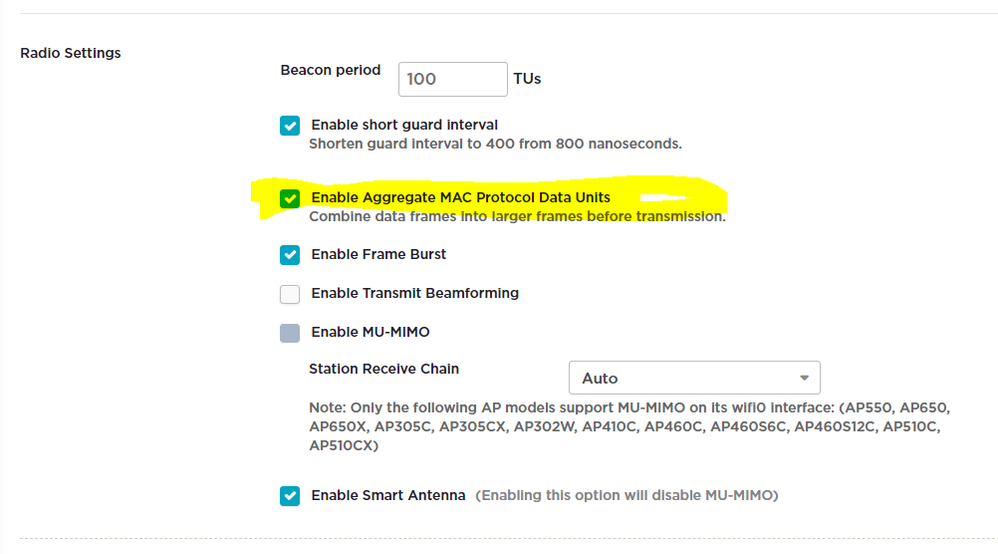

02-21-2021 10:06 AM
Anybody has any idea to what CLI command this translates (on AC radio profile)?
Enable Aggregate MAC Protocol Data Units: Select the check box to enable AMPDU (Aggregate MAC Protocol Data Unit) transmissions to reduce overhead when the transmission channel is busy. When you enable AMPDU, the HiveAP combines data frames into fewer, larger frames before transmitting them and is able to recognize the format of larger frames when it receives them. Generally, enabling AMPDU increases performance. Clear the check box to disable AMPDU. By default, it is enabled.
