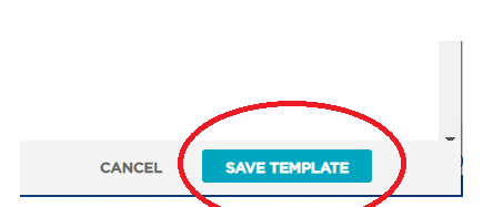

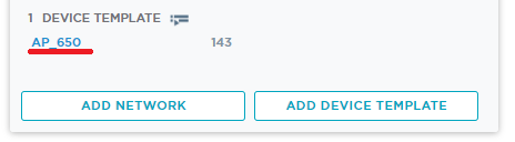

Thanks for this.  But just so i Understand.
Click on Configure, then Network Policy and click on the device template.
Once that comes onto the screen, just click Save down the bottom right.
After that, go back to manager Ā» devices, select the one im trying to update, and then do the delta update?
Because if i do that, then im going to get that orange icon next to all the AP’s, and will have to do a delta update on all the AP’s.
let me know though, please.
shane_sanderson
New Contributor II
Hi J,
Last time this happened to me i had to reset the AP template within the network policy
I when into the AP template, clicked save and then went back to the managed devices screen as was able to update the AP via delta without any issue
Cheers
