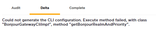

I made a minor change to the power on wifi1 interface (but basically any change i make), select the device, click on Update Device. Leave the default Update Network Policy and Configuration » Delta Configuration Update checked. I see the progress bar area show Queued for a few seconds, and then Device Update Failed is displayed next to the AP.
Hovering my pointer on the Device Failed to Update, i see this “Could not generate CLI configuration. Execute Method failed, with class”…………………….

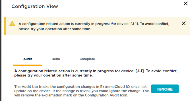

In clicking that, it was strange. I got this first:
I closed the box, refreshed the screen, clicked on it again and it didnt show that box saying something is already in progress. Dont know how that would even be possible, as ive been away from my desk for the last 45 minutes!
After the refresh, and clicking on it, i got this:
This is probably due to be going into the device template and clicking on save.

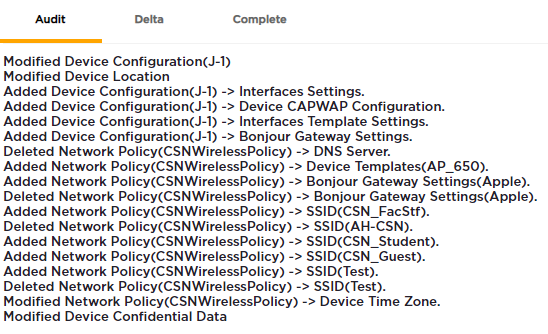

Clicking on Audit, i get this message:
We are running Bonjour gateway via Extreme, and have one AP in each division set up (with different priorities, just in case the AP acting as the main BJ GW goes down.
Does this help figure this out?

On the configuration missmatch next to the AP that you have just tried to update, if you click on this against either “delta” it should give the entire reason as to why the update failed

Okay, they all went orange. I selected just the AP that keeps failing, tried the Delta… it failed. it did take longer to fail about 40 seconds, but it failed..
<sigh>….
